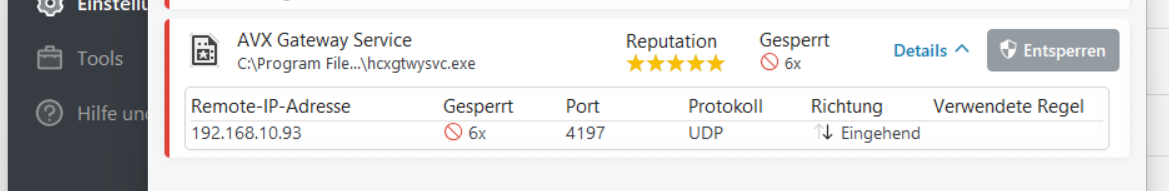

    What I had to do was to make an exception in the security/firewall software for the network sevice (see screenshot) to open UDP IP port 4197, as this service opens a UDP server and awaits messages from Hcontrol devices, which got blocked.
    (similar btw I had to do with NetLinx Studio for UDP 1319 and 1320, to be able to "Listen for Masters")
    Worst case would be to wait until the AVX-Suite gets released, as Manager is part of the suite (see the name of the service in screenshot...)

    Perfect Thanks a lot it work for my collegue!
