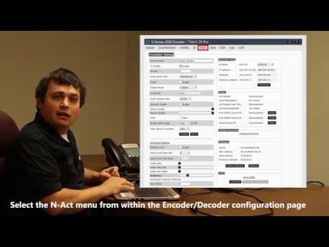

  • You can send LLDP status through N-Act programming. There will be a video (or two) on this exact issue released in the very near future but for the moment here is a link to how to implement basic N-Act programming https://youtu.be/8OLA2dNOR60
