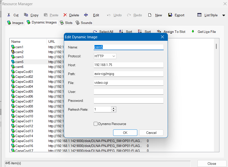

Does anyone have code examples in Netlinx that uses a AXIS encoder to display cameras on the touch panel. I have seen some code using PTZ(pan tilt zoom) but what if the cams do not support PTZ.
So code like this - this one has PTZ code so I am looking for no PTZ code
also use Dynamic images or not use dynamic images.
Note:
dvIPCams - is my device
sMyBase64 - is the encoded userid/password
SEND_STRING dvIPCams,"'GET /axis-cgi/com/ptz.cgi?camera=1&',13,10,'Connection: Keep-Alive',13,10,13,10";;
SEND_STRING dvIPCams, "'Authorization: Basic ', sMyBase64, 13,10";
like this
