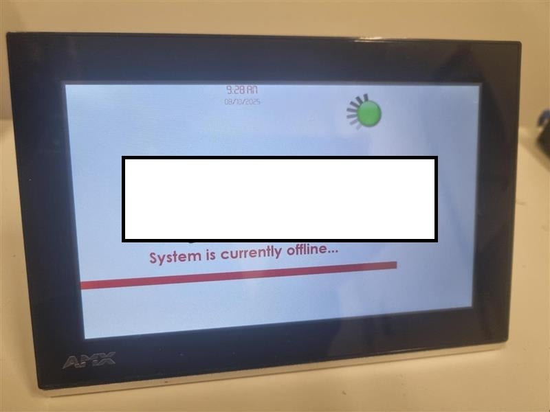

We recently had an AMX NX 3200 controller die. I replaced it with another NX 3200 unit. Gave it the same IP address as the previous, connected to it via Netlinx Studios and sent the rooms .TKN and .SRC files to it, as well as the .TP4 to the touch panel.
My issue is, as you can see in the picture below that the panel is 'connected' displaying the green LED circle however is displaying a 'room system currently offline' message and wont load the actual room system touch panel interface.
I checked the touch panel settings and can see it is pointing to the correct controller.
Any ideas? ![]()
Thank you!

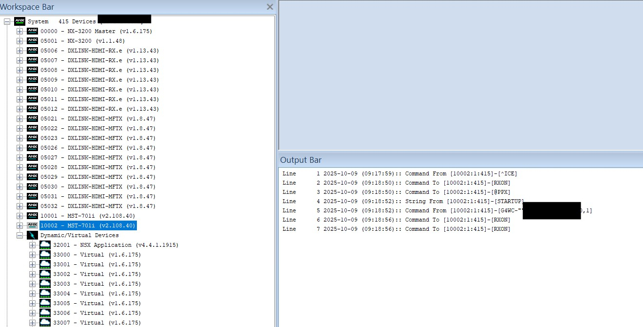

I connected to the controller and rebooted panel 10002 via Telnet command and attached below is the notifications it prompted. I can VNC connect to the panel remotely and can see it is displaying the same 'green circle' connected but offline error as pictured in the previous post.

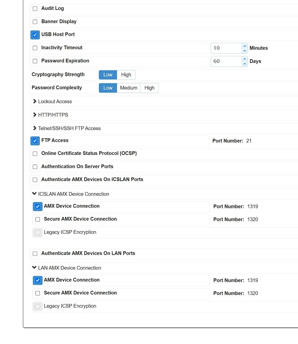

I connected to the controllers web interface and everything appears quite generic (see below).
Thanks
