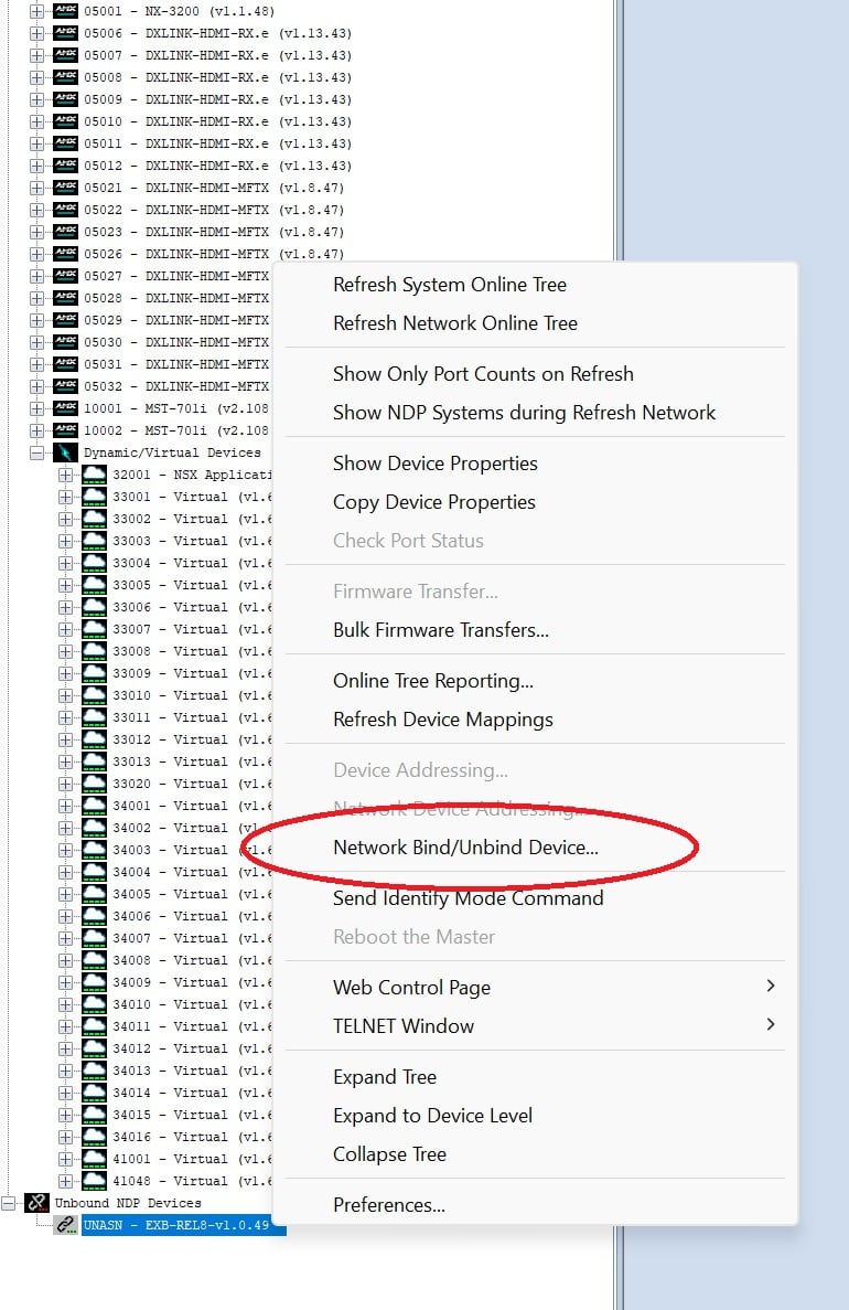

Hopefully a simple issue to fix, but i have an AMX-REL8 (relay box) that is unbound within Netlinx Studios.
Whenever i try and bind it to the active system, it flickers like its trying and just remains unbound.
I have tried a reset and a full factory reset on the relay box itself with no luck.
We did replace the AMX controller as it faulted which i am guessing has caused this issue - but i just figured pointing it/binding it to the currently active system would bind it.
Any ideas? :)

    Right-click and "Show Device Properties" to see the IP address. Is it in the correct IP range?
    Manual:
    https://www.amx.com/en/site_elements/instruction-manual-icslan-device-control-boxes
    You may do a factory reset, see pdf page 18.
    Worst case telnet to the EXB-REL8 box, following the instructions in Appendix A in the manual.
    With SET DEVICE, you set the device number for the box
    With SET CONNECTION you set the connection data to assign the box to the master (I recommend TCP as connection type).
