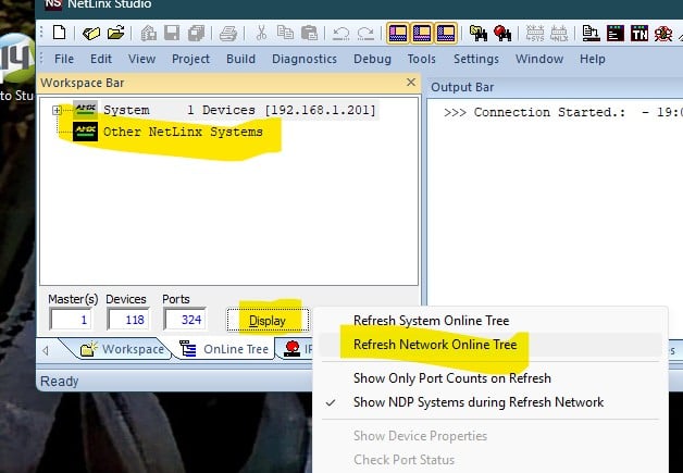

    Do not create a URL loop by pointing masters at each other. They will fight or fail. Only one needs to be told to manage the connection. It matters not which one. I usually pick the master with the least other things to do to manage the link. Also, do your masters have different system numbers? The DGX should be system 2 (or anything but 1 if the 3200 is 1). You won't see system 2 devices on the SYSTEM tree in Studio, you need to select REFRESH NETWORK ONLINE TREE in the DISPLAY where you can then see both (all) linked systems.

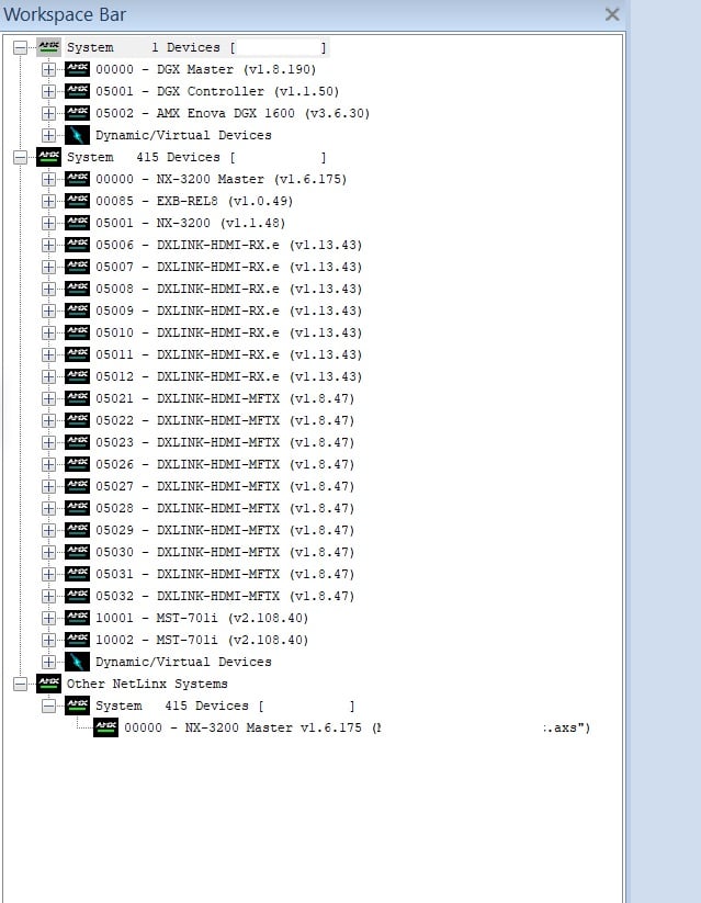

    Below is the Network Online Tree. It looks like they see each other? does anything look odd to you?
    I removed the URL Listing from one of the devices, so only 1 is pointing at each other now.
    Thanks!
