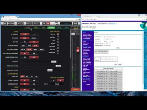

    However general best practice is to use a wired connection Via LAN to a dedicated wireless router for the Ui24R. This is the most reliable method and would absolutely be the way to go if using wireless devices to control the UI24R it in a professional application. There's a lot of resources on how to do that.. here's one. You might also become a memeber of the UI24R user group on FB. Very helpful.
    https://www.youtube.com/watch?v=X5zqiUwp7lY
