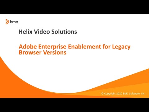

    If you are unable to update your RMS implementation, you can leverage (for a few more months) the Adobe Enterprise Enablement feature. I did a quick search on Adobe Enterprise Enablement - here is a video of a user creating and placing the config file to enable Flash on your device.
    https://youtu.be/nOcW1Ugt7Mk?t=96
