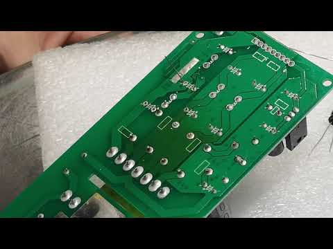

I had this issue as well on my Signature 12 (two weeks after my warranty expired, lmao) and can confirm that the capacitor fix took care of it. As the previous posters mentioned, the problem in question is easily recognizable by a regular popping - I thought it was a kick drum at first. If you unplug the USB cable going into your PC, it will likely go away and the rest of the mixer may still be usable. But since I use this mixer as a my primary audio interface, I needed it fixed.
I ordered the caps on Saturday night, they showed up this afternoon, and then by Monday evening I had a working mixer again for about $0.20 worth of parts. Well, I mean, I bought a bag of 50 caps so it was more like five bucks all told, but hey, now my mixer can conk out 24 more times and I'll still be good. Also, I did possibly the worst soldering job in my life on these and it STILL worked (the solder they use on the board wants about as much heat as my iron could kick out before it loosened, and I had a hard time getting the board clean). I think even someone without much electronics experience could probably handle this repair, just make sure your caps are oriented correctly, which should be easy if you use the other capacitors on the board as an example. If you are nervous about your soldering skills there are some soldering trainer project kits you can grab on Amazon for pretty cheap while you order your capacitors and that should help you get a hang of things.
One thing I noticed is that a few of the previous posts seemed to refer to one of the caps by an incorrect placement number on the board (C113). C113 is an smt cap - that is not the one you want. Unfortunately I didn't get a pic of the correct number before I put the mixer back together, but just refer to the image someone posted previously with the arrows pointing to the correct pair of capacitors and that should get you straightened out. I believe if you search youtube for "SOUNDCRAFT POWER SUPPLY CAPACITOR REPLACEMENT" there is also a youtube video that may give you some more views of the correct caps to replace, although the youtube video doesn't go into very fine detail.

I am a Soundcraft signature Mkt22 USB survivor, saved by the CAPACITOR FIX. It works.
Same story: great Mkt22 reviews, bought it, loved it, USB stopped working out of the blue, fixed under warranty (cost $200 shipping), power stopped suddenly a few months ago (3 years post-purchase), local guy changed PSU (cost $400), power back but intermittent, funky USB + 1 FX channel/panel not working + weird interference with computer audio (need to disable/enable soundcraft channels in sound panel to get computer audio to work). Insert screams of frustration. Add hours of trying to understand/change things out, etc.
Found a local guy who very nicely provided 4 x 100uL x 100V capacitors for free. Took a deep breath and did the surgery with a soldering iron (never touched innards of a mixer before). 1-hour later, presto... MKT22 back in action and working like a charm (maybe its my ears singing but it sounds better/richer). It's a great board for me when working (primarily home recording).

Well it turns out my repair guy had some 35v caps and we took out the 2 dodgy bulging caps, soldered the new ones in and the mixer works perfectly now, hopefully for many more years to come.
I had this problem on my MTK22 - USB attempting to connect, then dropping then attempting to connect, repeating the cycle over and over. It turns out that this issue was due to a failed power supply. The solution was to have the mixer serviced and the power supply replaced. I had my board serviced at Sound West Tacoma, which is located in Tacoma, Washington (USA). Due to supply chain issues it took months to get the required replacement part. Once they received the part the repair only took a few days.

Was about to throw the Mkt22 onto the highway and buy a Tascam 24 but read this forum and watched the famous capacitor fix video.
https://www.youtube.com/watch?v=Yw2BMyUK0uo&t=65s
To the guys who did the video fix... ten thousand thank yous!! As well, big thanks to those on this board who added their experience and advice on the capacitor/USB fix. A little nerve wracking to do the first time, but once done, super easy.
